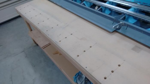

Brief Description:  Drill and cleco bottom skin to table

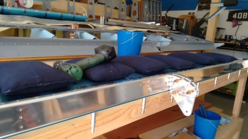

Weighted bottom skin (FL-902) to table top. Clecoed spar wit spar holes hanging over edge.
Drilling out every second hole (starting with second one back) for each rib (some go into 2x4 table frame - should not be a problem only need to be deep enough to nestle cleco on bottom of skin.
Removed everything and discovered that I needed 5/8 ths drill. Back and forth to Orchard.

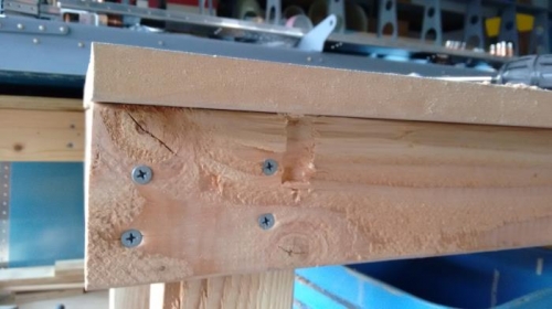

Drilled first two holes and discovered that the table 2x4 frame was in the exactly wrong place.
Marked and cut off 8' x " overhang with skill saw.
Put everything back together, drilled holes again, took everything apart, and drilled out holes with 5/8ths bit.
Weighted and set up to drill #40
Drilling out to 5/8s and frame was in way
Table trimmed and holes re drilled
