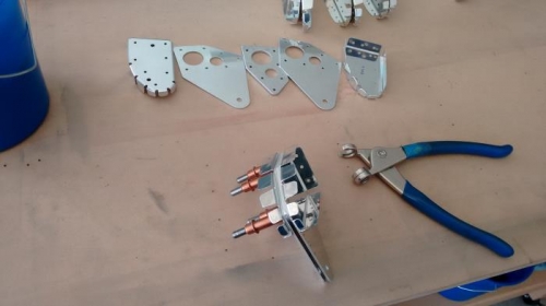

Date:  11-6-2014
Number of Hours:  1.50
Manual Reference:  7-13
Brief Description:  Assemble flap nose rib/brackets and drill to spar
Assembled Rib(s), Bracket(s) and spacer x 6.
Used two 1/16th inch washers and a 1/4 inch bolt/nut to keep bracket aligned while drilling holes to spar (enlarged to final size with #30 reamer).
Both spars done.
