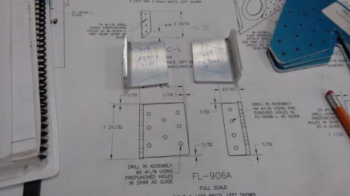

Date:  11-5-2014
Number of Hours:  3.00
Manual Reference:  7-13
Brief Description:  Fabricate FL 906A Left and right
verified correct angle stock to use. Measured, marked, and used band saw to cut rough dimensions. Used drawings and scotch brite wheel to shape bracket to final dimensions.
Will see when fitting to spar why 1/32 edge removal was needed. Clearance??
