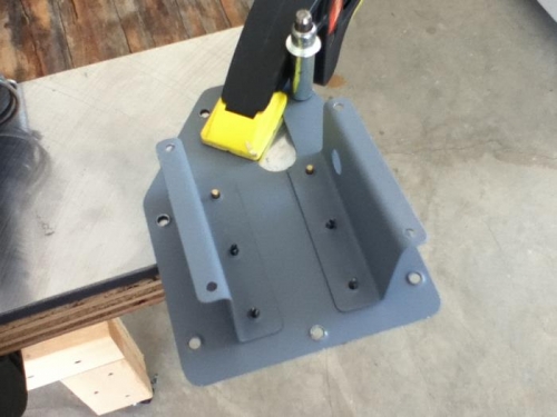

Brief Description:  Fitting trim tab servo
Riveting servo bracket to trim cover.
Clamped and clecoed to bench.
Back riveted flush rivets.
Attached servo with screws and nylon nuts.
Not able to fit assembly into elevator. Not sure how to squeeze it in.
Found the magic combination of twist and squeeze

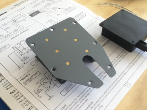

Back rivet brackets to cover
All rivets flush
All rivets flush
