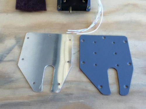

Brief Description:  Re doing trim tab access plate

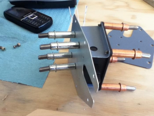

Trim tab cover plate holes for electric trim were slightly too close together. Ordered new cover, re dimpling and re drilling servo pack holes.

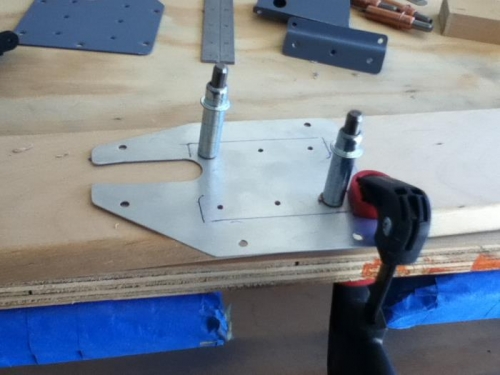

After marking bracket location I did a trial fitting cover to elevator. Pre drilled holes do not line up with installed nut plates. Off just enough that it will not fit without a lot of binding.
Reverting to original cover plate.
