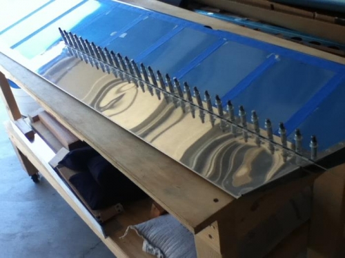

Brief Description:  Clamp and drill trim tab hinge to elevator

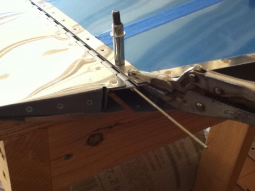

Cut small bocks of wood to wedge loose hinge to elevator spar - worked well and kept things well lined up.

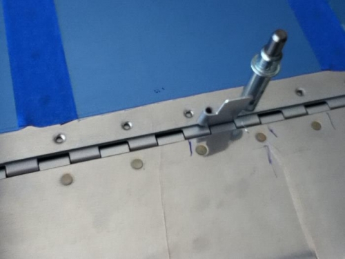

Used spare piece of hinge material to line up / measure gaps; drilled one hole on each end to set line, then drilled holes in between.
Drilling went well with no problems.
Spare hinge material to measure gap
First hole and cleco
All holes drilled and clecoed
