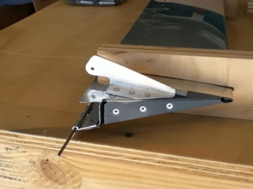

Brief Description:  Rivet hinge to trim tab

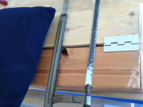

Removed hinge and cut to size. Weighted it down between two 2x4's, hinge loop down and cut with hack saw. Cleaned up with scotch brite wheel.

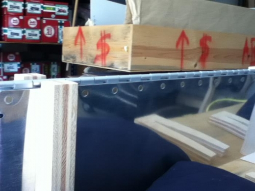

Re-clecoed hinge to trim tab from center out. Slightly better fit of skin to spar, more even.
All rivets squeezed. skin a lot smoother. First center rivet needed to be drilled out I used 3-3.5 instead of 3-4 rivet. TOO thin on driven side - would be too weak. New rivet fits a lot better.
Pop riveted the end rivets cs-4-4
