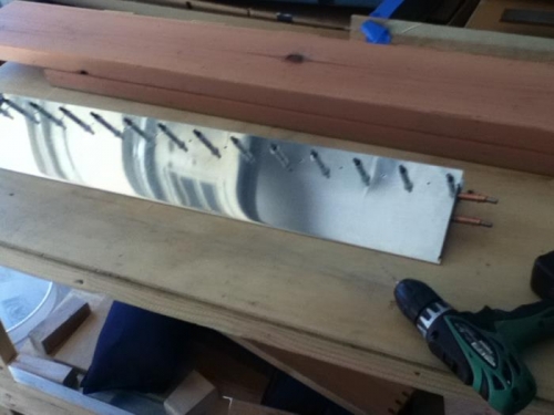

Drill spar and skin to #40, dimple and countersink
Clecoed spar to skin. Drilled out all holes to #40

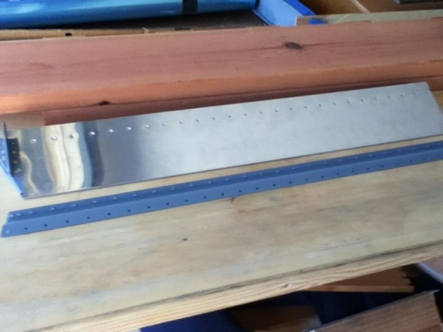

Dimpled skin and bottom holes in spar.
Countersunk holes in top of spar.
Primed spar.
Clecoed to drill

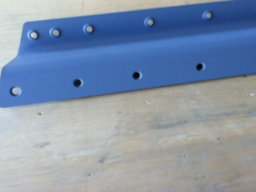

Spar dimpled on bottom countersunk on top and primed
Both skin and spar complete
