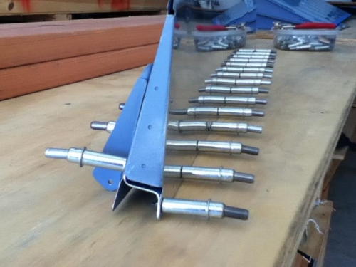

Drill out end holes in trim tab to #30 and dimple
Clecoed the spar to the skin (to hold everything still) and drill to #30 holes on both sides.
Drilled, cleaned, and dimpled.
Clecoed to test fit.

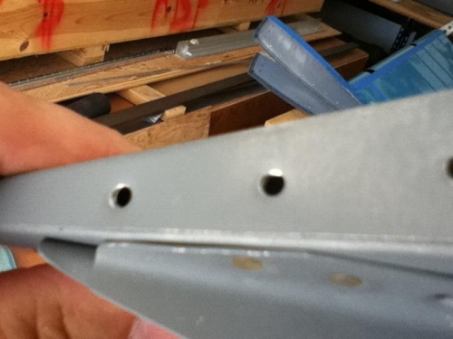

Clecoed and ready to drill
Drilled and dimpled

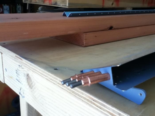

#30 clecoed to test fit
