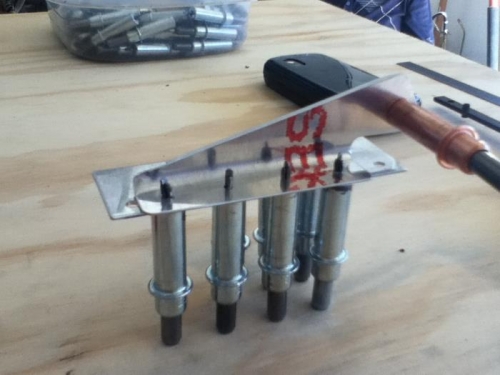

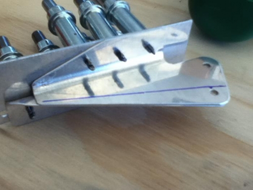

Used scrap piece of aluminum to hold brackets together to mark and cut.

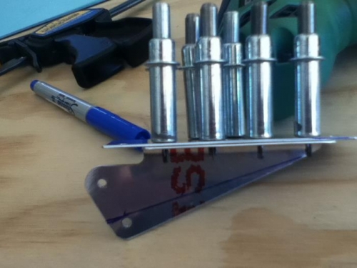

Cutting with shears did not cut each side even, took too much off one side.
Using scotch brite wheel cleaned it up nicely but still concerned about the extra 2/32" removed from both pieces to even it up.
Ordered two new E-917 and E-918 trim tabs. "Just In Case" (think Jimmy Leward and the galloping Ghost P51 crash at Reno!)

Marked for cutting
Marked for cutting
Attached to scrap
Attached to scrap
After cutting and grinding
