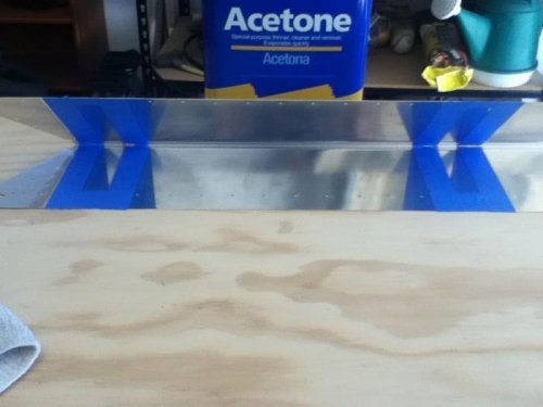

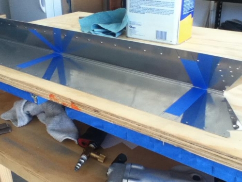

Foam ribs have been cut and using drawings and ribs determined location where they need to be installed. Marked off location, and masked for scuffing with 150 grit Alum Oxide sand paper.
Scuffed and cleaned where ribs attached. Removed tape and taped where ribs attach.

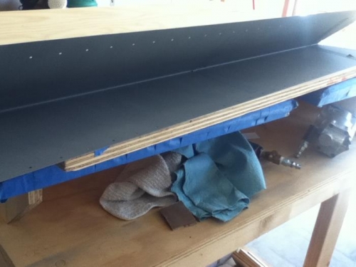

Scuffed rest of skin, cleaned, and primed.
marked off where ribs attach
taped off rib attach section
primed
primed
