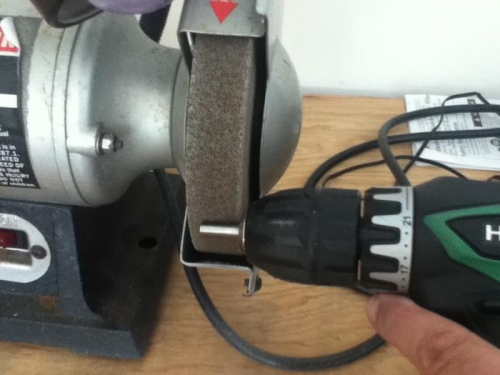

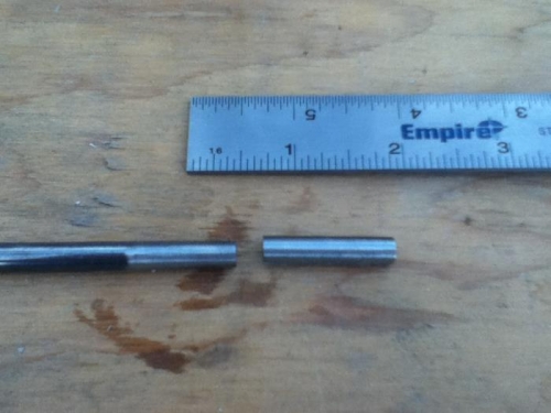

Busing was ordered as a 1' stock piece of 1/4" OD 1/8" ID and cut off a 1" piece. Had to scotch brite wheel the OD slightly to allow it to fit in the bearing hole.
Made the bushing more evenly round by chucking it in a drill and counter spinning it against the moving scotch brite wheel.
Minor touch up to get even snug fit.
Cut 1
Cut 1" piece from stock
Use scotch brite wheel to evenly reduce OD
