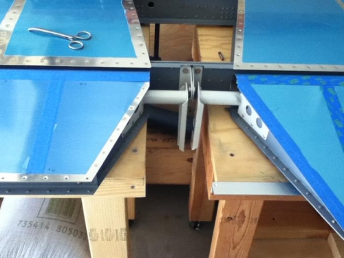

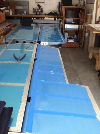

Attached, measured, remove, adjust, repeat until elevators fit even. Once I had the best fit (closest to even trailing edge and counterbalance assemblies lined up with Horizontal Stab I used 1/4 bushing to drill the elevator control horn.

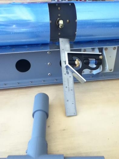

measured all 4 rod end bearings to same
lined up elevators before drilling
