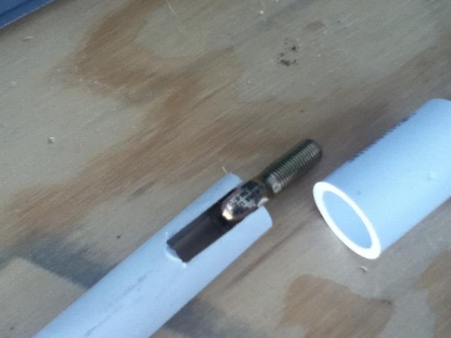

Brief Description:  Build rod bearing install tool
Install rod end bearings to both elevators with 13/16 between spar and center of bolt.
Need to build rod end bearing 'wrench' out of 1" PVC.
Cut notch same size as rod end, glued into PVC joint. Once it was dry cut flush with joint.

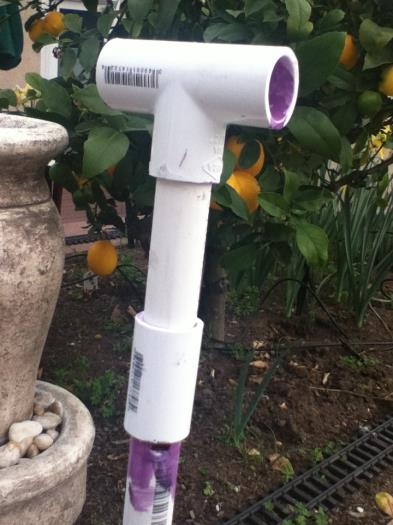

Cut, and glued T handle to PVC joint. Let glue dry several hours and then tested.
Worked!
Notch hard to cut straight, second attempt
Glue drying, notch needed extra time because less outward pressure to keep tight in joint
Tested and worked!
Tested and worked!
