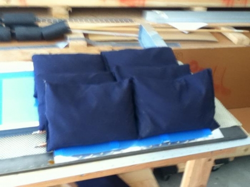

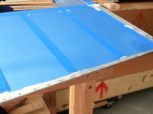

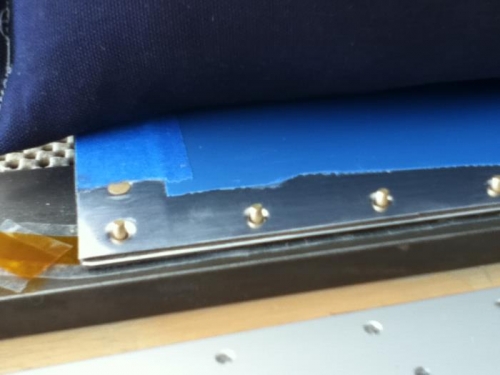

Epoxied trailing edge / wedge two days ago. Removed clecos, cleaned holes, taped rivets in place.
Successful back riveting. Some pucker / wave due to too much epoxy? Edge is still nice and straight.
