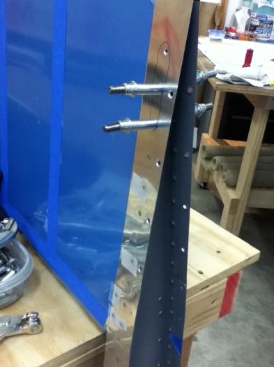

Rivet the rib to elevator skin
Finish up riveting elevator skin to tip rib
First two rivets were 3-4's rib / cb skin / skin.
Rest are 3 -3.5s
Clecoed and ready to rivet
Riveted, last three holes left open to get to trailing edge
