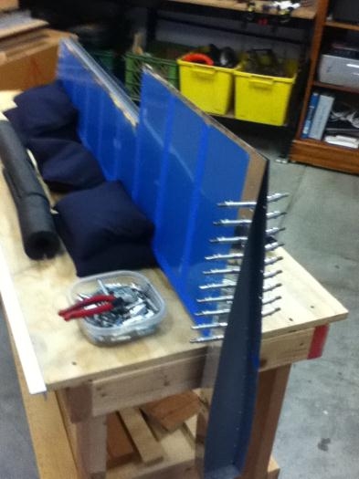

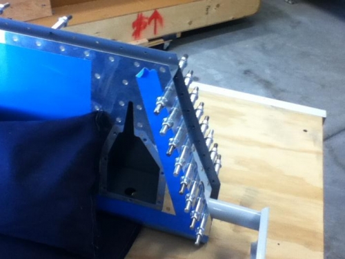

Rivet bottom skin to trim tab spar
AN 426 AD 3-3.5 flush rivet bottom skin to bottom of trim tab spar.
Rivet 3-3.5 flush rivets to skin / root rib top and bottom.
Rivet CB skin to Elevator skin on inside of tip rib.
