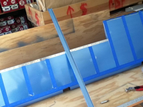

Match drilled holes in trim tab spar to skin.
Countersunk the top holes, dimpled the bottom holes.
Scuffed and primed the spar.
Cleaned up, re-scuffed, and touched up primer on inside bottom elevator skin.

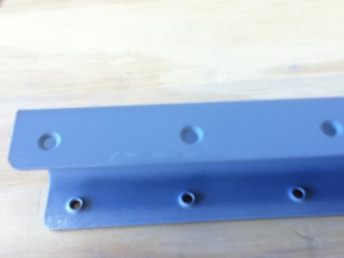

Replacement spar ready to drill & dimple & countersink
Dimpled, Countersunk, and primed

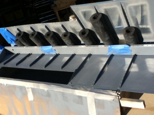

Touched up primer on elevator skin
