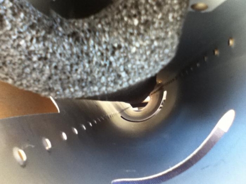

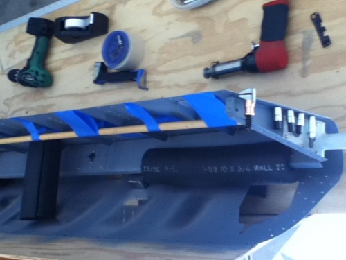

Continue riveting spar to upper skin.
Started trying to back rivet - one rivet went well, next four did not. Drilled out four rivets.
Using rivet gun with mushroom head and small bucking bar - much better results.
Pretty good results - blind bucking reaching over / around / between edges of skin and spar.
Clecoed, and foam spreaders
All rivets bucked - in the blind
