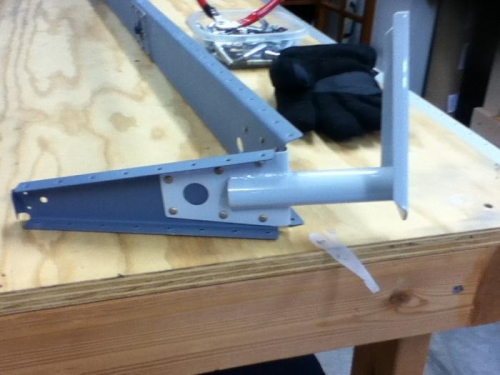

Brief Description:  Remove control horn - installed WRONG. Reinstall
Installed control horn backwards - unbelievable!

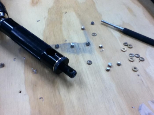

Drilling out 12 really nice rivets, turn around and redo.
All drilled out no problems, used rivet removal tool and it kept everything nice and centered. All drill holes perfect and no damage to rivet holes.

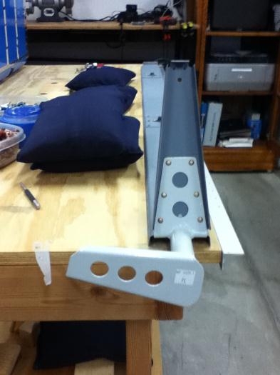

New rivets installed, double checked three times. Nice new rivets, everything smooth.

Rivet removal tool - worked great
What is supposed to look like
