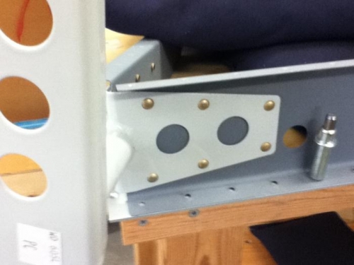

Squeeze rivet, AN470AD 4-4 rivets, WD 605 elevator control horn to spar.
All rivets went in nice and even.
Clecoed upright spar to table and supported with sand bags. Very stable

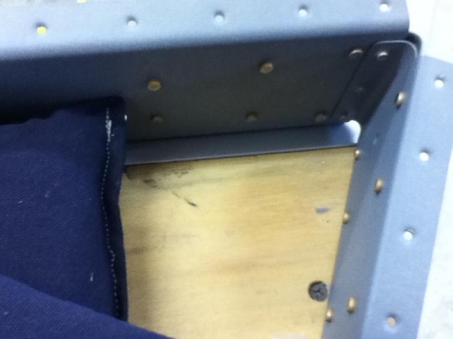

Outside nice and smooth
re used angle aluminum to cleco spar to table
inside looks good too
