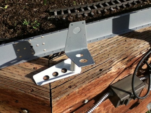

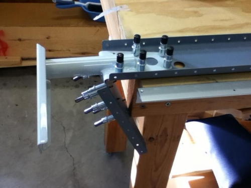

Brief Description:  Attach, drill out, rivet WD-605 left control horn
Fitted WD-605 control horn and test fitted to elevator skin. Everything lines up. Drilling out holes to #30.
Scuffed up inside of control horn and spots on spar. Primed and waiting to dry.
Ready to drill
Ready to drill
Inside surface primed
Spar touched up.
Spar touched up.
