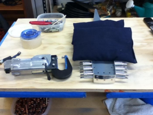

Rivet together the left counterbalance assembly. Start with riveting E903 and 904 together.

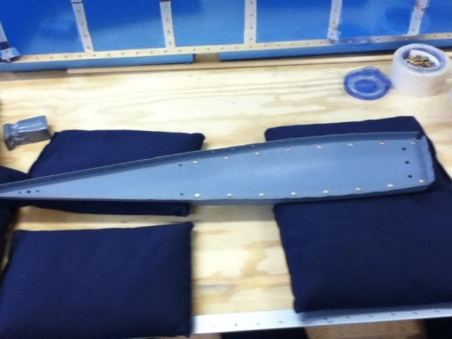

Rivet counterbalance skin using squeezer. Needed to touch up a couple countersink holes.
Nice and smooth

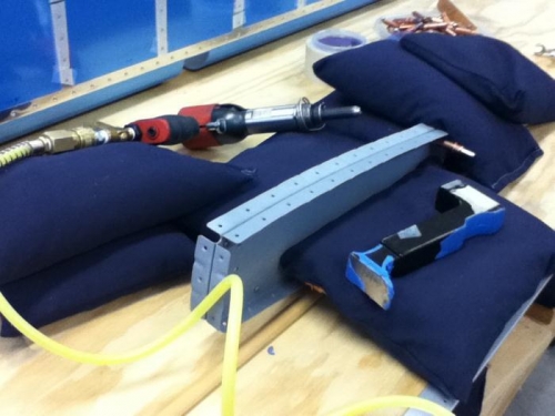

Rivet gun for 4-4 rivets, flange too deep for squeezer
Nice and even
Nice and even
Squeezing 3-3.5 flush rivets
