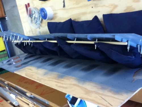

Brief Description:  Prime and rivet stiffeners to left elevator
Primed the inside of elevator skin.
Started riveting the stiffeners to the elevator top skin.
Drilled holes and clecoed the skin to plywood attached to the work table.
Using squeezer on end rivets and then switching over to back riveting.
