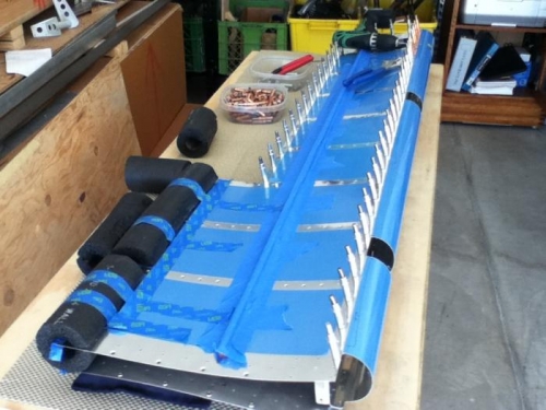

Brief Description:  Begin the left elevator
Waiting for epoxy to dry on right elevator trailing edge.
Beginning assembly of left elevator.
Match drill reinforcement plates to left spar (already done earlier, but double checked.)

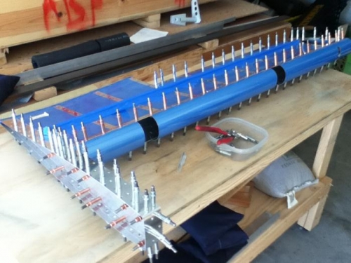

Cleco E-902, 905, 907 (spars and rib) to left elevator skin.
Drill out bottom holes to main spar for cs 4-4 (blind rivets) to #30
Attach CB assembly and drill out holes (#30 for rib to spar attach) to #40.
Only holes left to drill are the root rib to spar. Need to disassemble spar from skin to get to holes.
Drilling out #30 bottom holes in spar
Everything supported and protected
