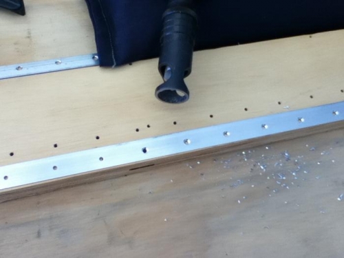

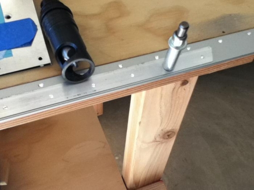

Countersink both sides of AEX wedge. Clecoed wedge to angle aluminum ready to remove metal.
Countersinking using wood backing was much easier than using aluminum angle. Easier on countersink bit too.

Clecoed to angle aluminum
Countersinking with wood backing - easier
