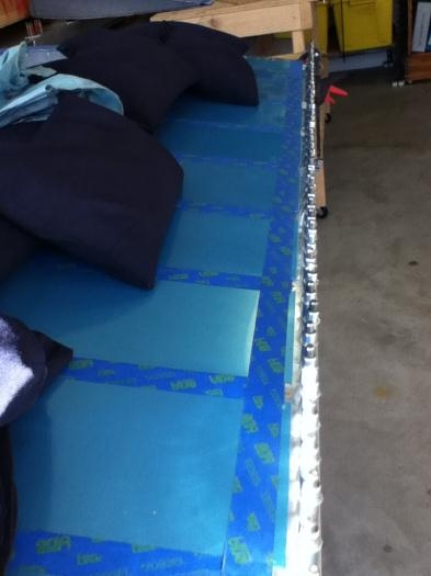

Brief Description:  Drill holes in trailing edge / AEX
Drilled out initial holes every 10 inches. split the difference each time after that.
All holes drilled with air drill. MUCH easier and faster. But it did make the compressor work so much that I had to put a fan blowing across the compressor motor. Also drained the tank - LOTs of water had accumulated.
