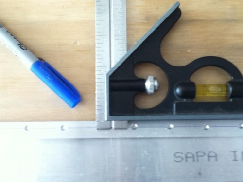

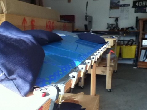

Brief Description:  Set up trailing edge to drill
Marked AEX wedge by using carpenters square clamped to table and running AEX wedge past it, set to 1/8 inch, with permanent marker. Everything was fixed except the wedge moving past. Worked surprisingly well.

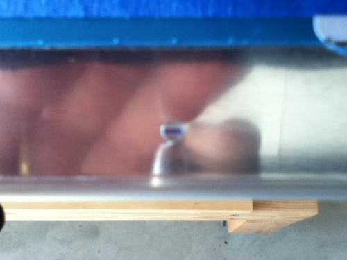

Trailing edge, with wedge between, is securely clamped to table / angle aluminum. line is even in every hole.
Everything ready for the scary part - drilling the holes.
