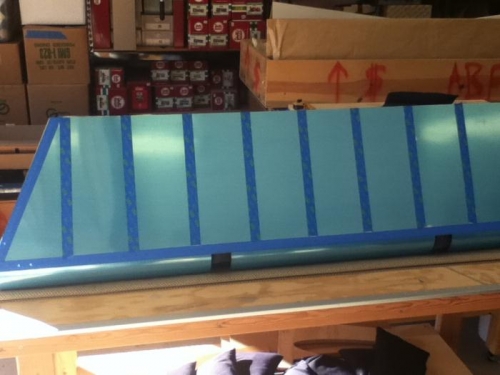

Brief Description:  Rivet stiffeners to bottom of E-901 skin
Stiffeners were attached last night. Looks like it will be easier to back rivet this side because I will not need to have upper skin pulled all the way back?
All rivets went in well. No problems.
Clecoed and ready to rivet

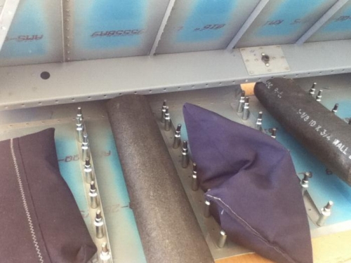

Foam pipe insulators provided just the right spacing
