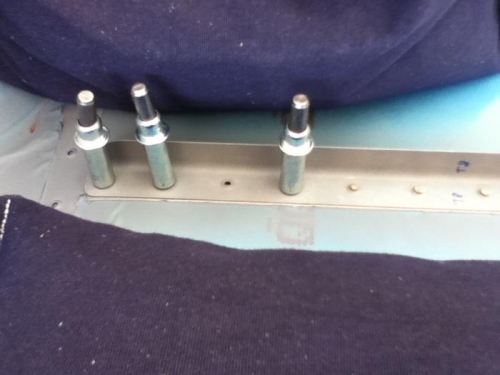

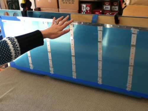

Brief Description:  Back rivet stiffeners to upper skin
Stiffeners clecoed, blue painters tape removed, ready to rivet.
Re setting the dimples using a combination of squeezer and rivet gun with female die driving against back rivet plat with rivet installed. Second method working pretty well; two pass method, reset dimple, then back rivet. Double work on each rivet but good results.
