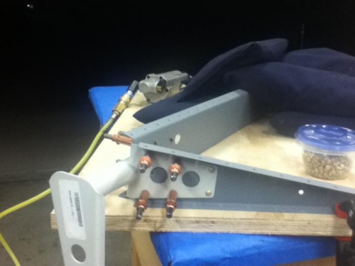

Brief Description:  Set up to rivet E605 R to spar assembly
Rivet control horn (E 605 R) to spar assemble. Setting up and checking fit once more.
Everything lined up well.

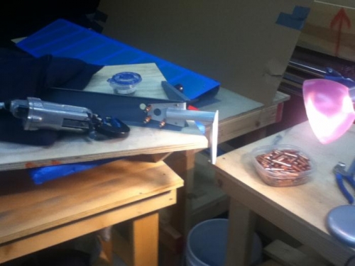

Used raised table with sandbags and clamps. Used small lamp from side to give better light, it helped a LOT keeping the rivet head aligned.
12 good rivets, no drill outs.
Raised, Sandbagged, easy riveting

Added light from side
