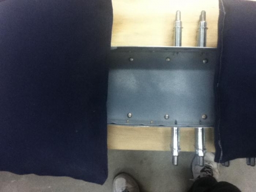

Riveting CB skin to ribs with squeezer. Good position raised and sandbagged.
All rivets good, no drill outs.
Raised table and sandbags make a great stable platform to rivet on.
Used dimpler to reset some dimples to get all rivets to be really flush / flat.

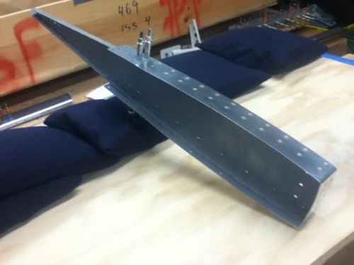

Sandbagged and clecoed for riveting

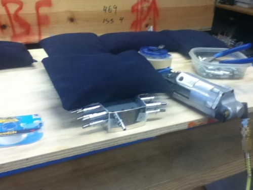

Easy reach, stable set up for riveting
All flush rivets good
