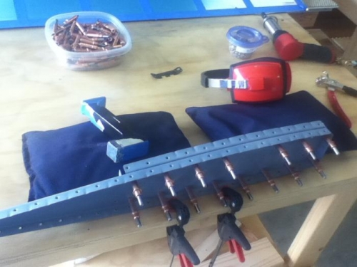

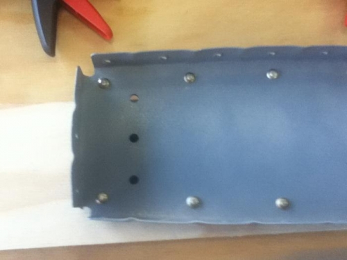

Using rivet gun to set AN 470 AD 4-4 rivets. Squeezer wont reach both sides.
Two rivets got a bad set and were drilled out using rivet removal attachment for drill. Seems like it is not very good at centering on the rivet. Need to do some test rivets to see if its technique or defect / offset in drill attachment.
Clamped, braced, and bagged
Driven side
Driven side
Shop head side
Shop head side
