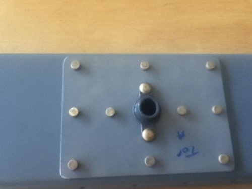

Rivet reinforcement and nut plates to spar
Used squeezer to install AN 470 AD 4-5 rivets (reinforcement plat to spar) and AN 470 AD 4-6 rivets (Nut plate / reinforcement / spar).

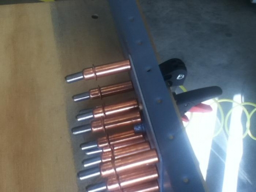

Clamped and first rivet squeezed
Forward facing spar side
Read facing spar side
