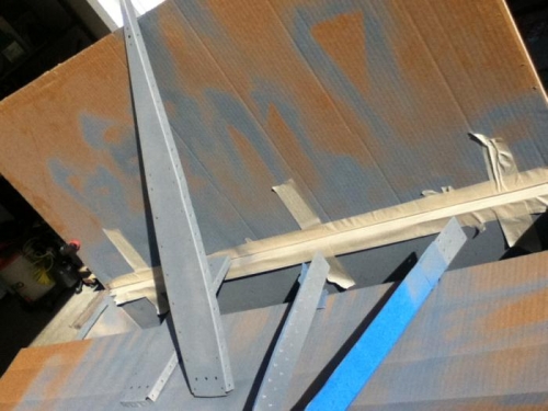

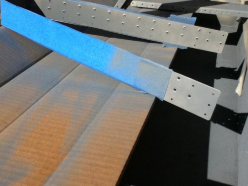

Deburr, prep and prime CB ribs and skin
Dimpled, scotch brite, cleaned, and primed CB ribs and skin.
Had to drill last two holes that are skin/ CB skin / rib. Will need to drill out skin holes during fitting.
