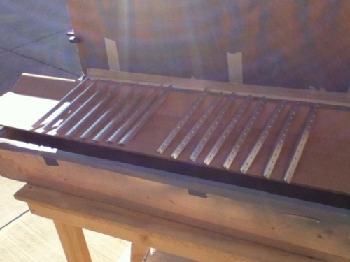

Cleaned all stiffeners, dimpled, and primed ready to install.

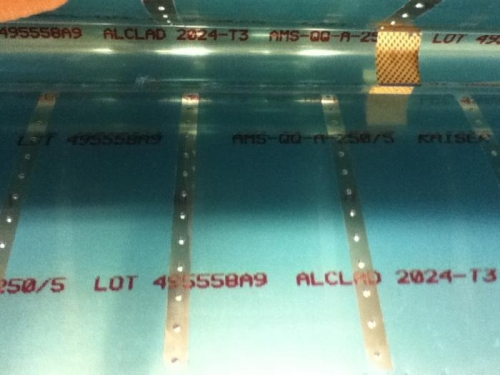

Dimpled skin stiffener holes. Very carefully used dimpler and table to not create any new skin bend/wrinkles. So far so good.
Marked, solder gun cut protective covering, and removed plastic covering where riveting will occur. Used dimpler table to support skin and bring things higher to work on. Much better results.
Used stiffener and spar as guide to melt outlines. Worked well
Inside skins are ready to clean and prime - much less primer area but only removing plastic where stiffeners, ribs and spar attach. Outside skin rivet areas protective cover removed and re covered with blue masking tape. Ready to rivet and minimal skin exposed. Should be a lot few scratches.

Stiffeners primed
Stiffeners primed

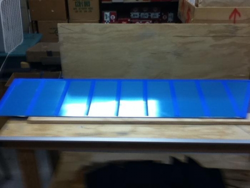

Protective skin removed and replaced wit tape
Ready for scuffing, cleaning, and priming.
