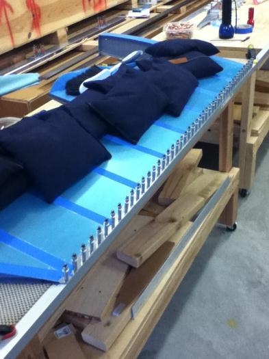

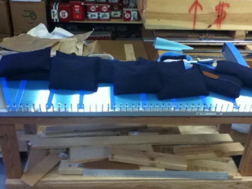

Brief Description:  Fit trailing edge wedge and drill rivet holes
Fit trailing edge wedge to right elevator. Cut wedge to length. Rivets on stiffeners are a bit too high and are interfering with a good fit. Using angle rivet head and back riveting last rivet on each stiffener.
All holes drilled but first one on right side the wedge hole is enlarged. Need to evaluate once I take it apart.
needed to re-set end rivets.  Too tall
All holes drilled and clecoed to angle aluminum
