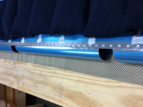

Riveting the bottom of the elevator skin to the spar using blind rivets.

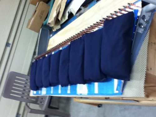

Directions say to have you place elevator on flat surface and use sandbags to hold everything down.
All blind rivets successfully installed.
Clecoed, sandbagged , ready for pop rivets

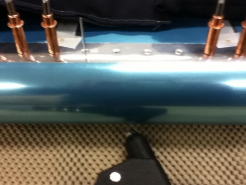

Installed pop rivets from center out
All pop rivets installed
