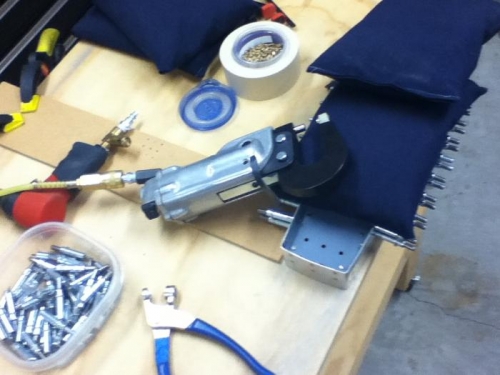

Brief Description:  Rebuilding right counterbalance assembly
Parts for right counterbalance assembly match drilled, dimpled, countersunk, and primed.
Riveting CB ribs together with AN 470 AD 4-4 rivets - need to use rivet gun and bucking bar.
Riveting the CB skin to the rib assembly.

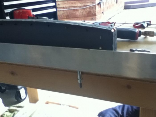

clecoed to angle and braced with sandbags
Angle clamped to table
Braced with wood to push against and weighted with sand bags
