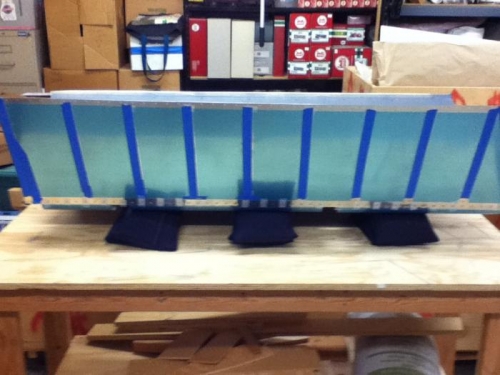

riveting spar to upper right elevator skin
Finally got a process down to get consistent rivets. making progress getting all flush rivets flush
All rivets driven for top skin to spar
Sandbags helping hold up and out
Drive from outside blind bucking bar behind
