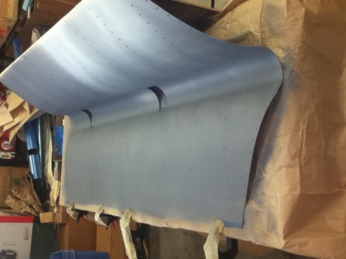

Brief Description:  Prepped and primed inside right elevator skin
Taped skin to back supported plywood. Cleaned with acetone. Primed entire inside of elevator skin.
Too many scratches from dimpling so I needed to rough up with scotch brite and then prime.

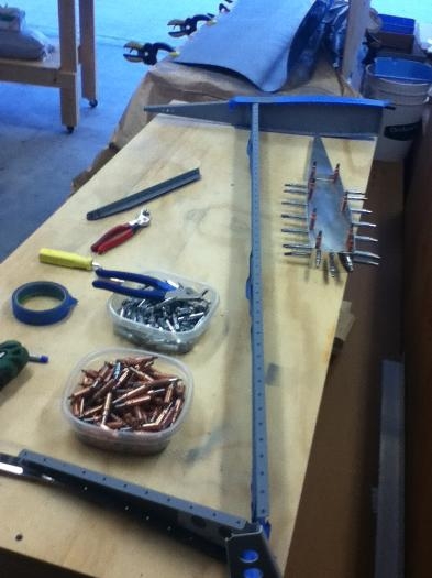

Inspected spar / counterbalance assembly and touched up primer on both sides.
Primed and ready to rivet stiffeners.

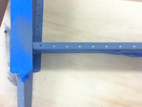

Cleaned up along rivet holes
Spar assembly and skin ready to rivet
