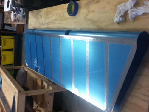

Brief Description:  Redoing right elevator -stiffeners and skin

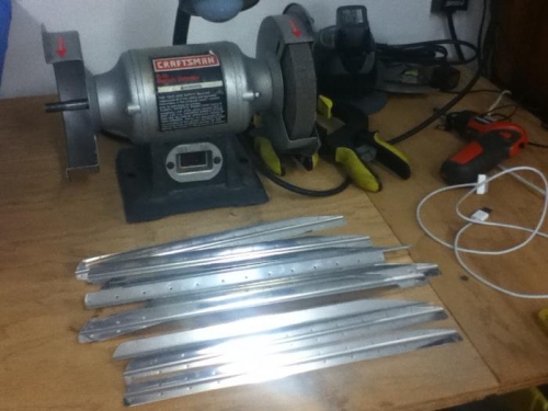

Reordered skin and stiffeners have arrived and I am starting by re making the stiffeners (so I don't have to drill out dozens of rivets!). marking, cutting, and deburring stiffeners first.
Inventoried new parts first, cleaned up / labeled small containers for some of the rivets. Inspected new skin and it looks much better, no wrinkles / bends.
Competed Stiffeners and masking / removing protective cover of outside skin.
