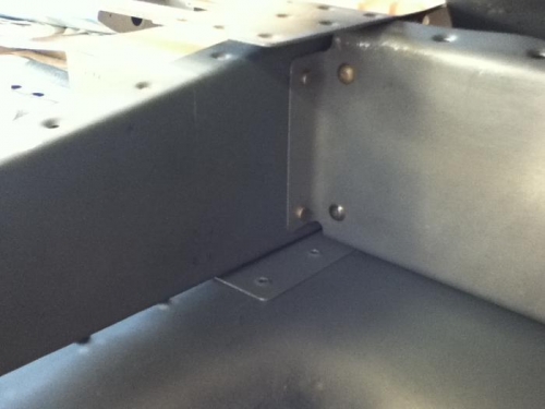

Brief Description:  Attach counterbalance assembly to elevator
Cleco and rivet counterbalance assembly to elevator

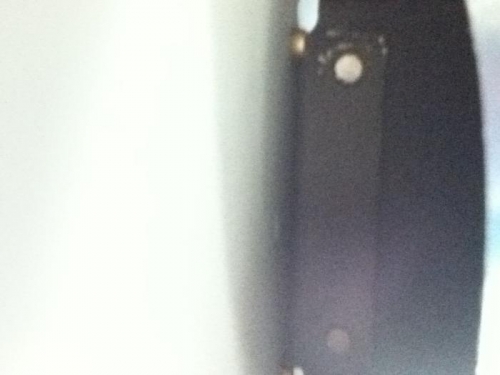

Riveted 4 AN470AD 4-4 rivets joining rib assembly to spar. Used squeezer for three but had to use offset extended rivet shaft to reach final rivet.
