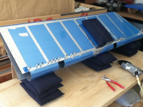

Brief Description:  Rivet spar to top skin
Cleco spar to top side of skin and figure way to efficiently back rivet.
50 rivets, 5 needed replacing.
Used squeezer for rivets near hinge cutouts. Back riveted the rest. Drilled out rivets were set using the squeezer - could not keep head perfectly straight and not able to see tail when squeezing behind skin.

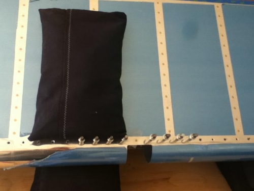

Sandbags good extra hand
Helps bring work higher too

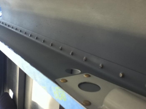

All rivets set
All rivets set
