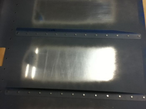

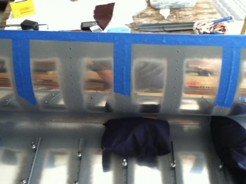

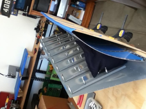

Brief Description:  rivet stiffeners to top right elevator skin
attached piece of plywood to back of table to hold up one side of elevator skin. taped edge of skin to plywood, attached stiffeners to top side of skin. Now rivet tape rivets to outside, pull down and rivet!
Riveted 124 flush rivets, back riveting, with no drill outs. Top of right skin done!
