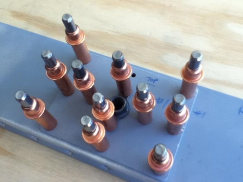

Begin riveting the right elevator together
Rivet the E-910 plates and K100-6 nut plates to spar. 470-5 for plates and 470-6 for nut plates
