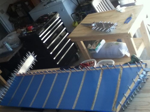

Brief Description:  Disassemble right elevator and deburr and dimple
Disassemble the right elevator and drill out #30 holes for control horn, deburr required holes and dimple spar holes and rib holes.

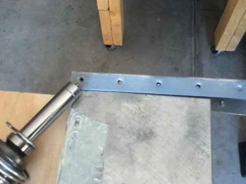

Had to use back rivet plat to get the last three holes ribs.
All dimpling done! Jeanine got home in time to help me with the dimpling of the hole that I had to use the BIG dimpler to reach. Took 10 minutes to do what would have taken me 20-30 min
Removed all clecos
Removed all clecos

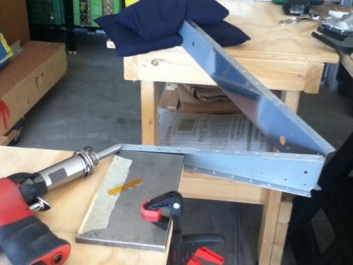

Sandbags make a good extra set of hands
Back rivet plate with countersunk hole to reach narrow dimple holes
