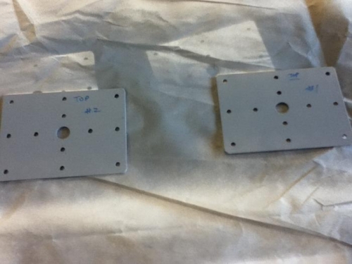

Brief Description:  Start building the right elevator skeleton
Begin building the skeleton of the right elevator. Match drilled E-910 reinforcement plates to both right and left spar. Might save time when building left elevator.

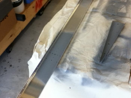

Fitted, match drilled, and dimpled E-906 rib to E-902 spar. Scuffed and primed areas where parts meet.
