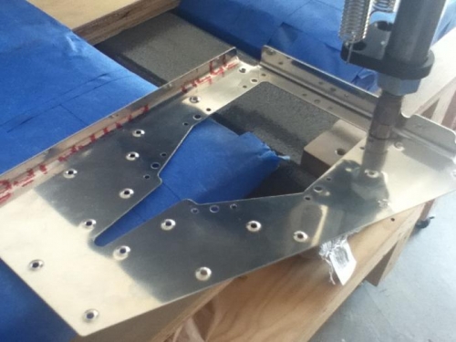

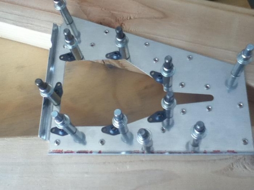

E-615PP reinforcement plate needs nut plates riveted at a later stage so I'm match drilling and dimpling holes for rivets. ?? Maybe nut plates too ?? I have a #6 dimple on order for the screw holes so I can to those later.

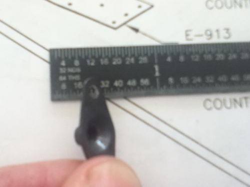

Nut plates cannot be 'dimpled' too small / stiff. Need to counter sink them.
nut plates clecoed in place for drilling
Dimpling reinforcement plate was easy!
Cant dimple need to countersink
