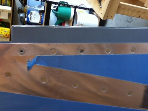

Jeanine helped me set three rivets. they have to be drilled out. Heads came up out of countersink.
Ended up using MK-319-BS blind rivets on last hole both sides.
Nicked the shop head side of one rivet and need to drill out and replace. Going to use oops rivets on next to last two rivets.
Jeanine helped me reset the last rivets

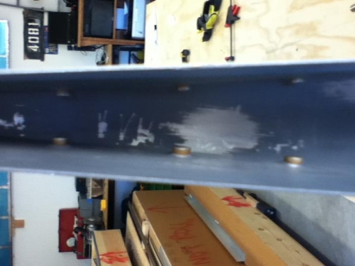

rivets set, rib scuffed, time for more primer
Blind rivet, normal rivet, two oops rivets
